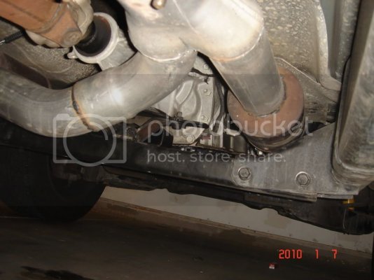

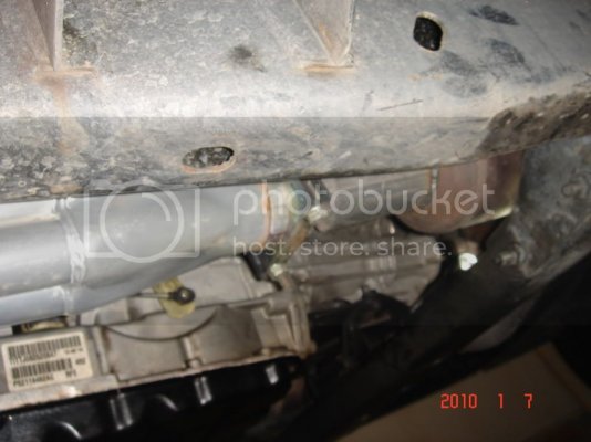

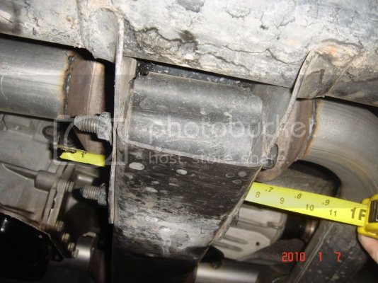

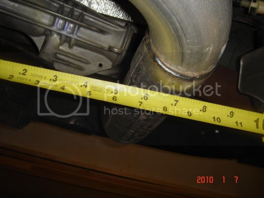

Couple things to note, I went with the pacesetter off-road Y pipe and spliced in the cats opening both sides up to 3". For yours since you already moved the cats back in anticipation, you will probably end up having to splice open the side of the cat leading to the header and have a 3" adapter welded in so they will just slide over the cone. I chose to have them beable to just slide on and NOT welded on. Actuall the whole Y assemble is welded but it is clamped to the headers and to the single line heading to the muffler. Reason we did this was so A the headers could be removed if I had to put them back to stock for whatever reason and B for when we pulled the heads to work on them with the cam and I am glad we did that.

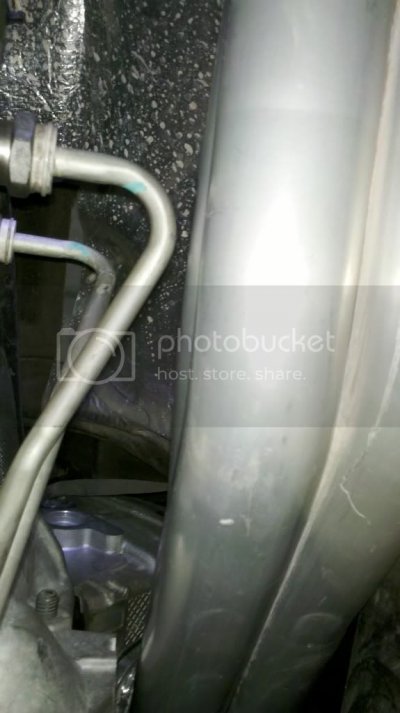

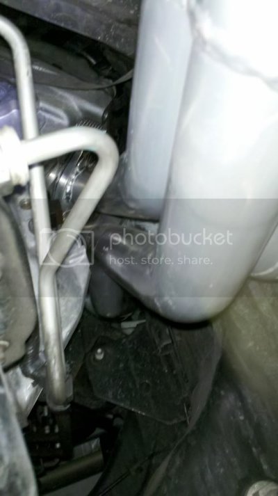

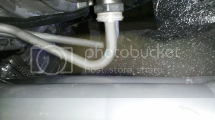

Took these for Nick a few weeks ago for the transmission line placement next to the headers:
Keep an eye on these lines when doing the install, mine have a solid 1/4" or so of separation while nicks are touching. Also look at the **** placement on the header, on mine the passenger side header was faced up instead of at an angle and I had to hammer in my floor board/heat shield there to be able to use the front O2 on that side. Also had an issue with the alignment tab on the passengerside. It looked fine when the truck was in the air but after it was set down you could hear a grinding and popping noise coming from it when I turned. Turns out it was this tab that was causing the issues because it was rubbing on the header while on the ground.
If you need any more information or dims or anything just ask and I can get them when I get home.

I have no issues with my fitment on mine. The cats, if you look in the pics above, on mine were shortened by about an inch on each side in order to get the 3" opening for the Y pipe. It can be done and from the sounds of it he is basically there, all he needs is the adapter to go from the cat to the header collector and it should be good.

...Took these for Nick a few weeks ago for the transmission line placement next to the headers:
There's a pretty easy fix for this. Disconnect the offending line. Move the nut back an inch or so and then trim 1/4 off the flared end of the line, reflare the pipe and bolt it back up. It's done in under 20 minutes.

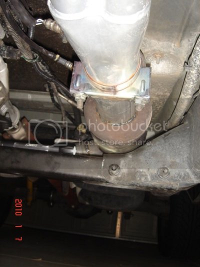

I have a couple pics of just the Y and no cats, let me see if I can dig them up, but if memory serves me correctly, we just cut the Y and inserted the cats in them so I think the y without the cats sits right on the crossmember or at least towards the front of it.

That would depend on what cats you go with. Mine are the stockers and it all fits really nicely and it comes apart real simple like to get the headers off

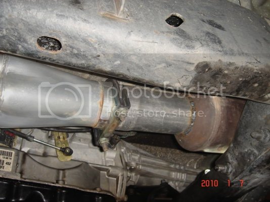

Best pics I have of the pacesetter Y with no cats:
Looks like it sits further back than I thouoght it did

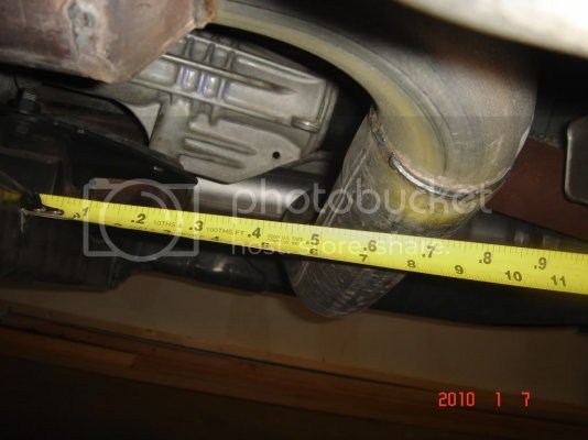

if you want i can get you a dim from the end of the header collector to the trans support later tonight
