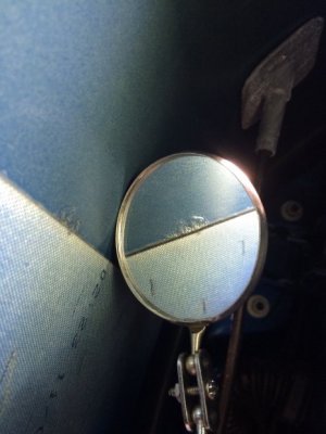

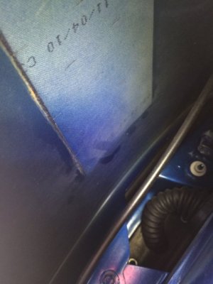

Pulled my 2011 apart today - Sport 1500 4x4 Quad Cab
Truck is Mint , only 26,000 miles
Well , enjoy the pictures
Now I have to figure out how to treat the one rust spot from the backside that has not bleed through yet
And like mentioned , that fiberglass tape is not coming off
Was also told if I tried to remove it the fender would come with it - It's pre attached to the new fenders straight from Mopar

Another

Another. Look at mirror

Nice pics, that sure beats the ones I posted!
Damn man that sucks... Maybe try soaking it with wd-40 to displace any moisture and then soak the **** out of that whole area with something like fluid film.
This whole thing is such bs this shouldn't even be a problem...

Exactly what I did today on both fenders - That stuff is like rock hard adhesive
Honestly , I think the only way you could get it off is with a grinder , and that's not happening
Talked to some body shops today - They told me it's an bonded material that gives the fender strength or body thickness , the metal is so thin , it's needed to keep the fender from deforming or buckling
$50,000 MSRP 2011 Ram Sport , 26,000 miles , always garaged every night since new , washed regularly - I can't even remember the damn thing even driven in the rain
I got a headache

Thats pretty pathetic if you ask me. Needing a material on the back to keep it from deforming because its so thin?? What do you want for $40000???
So did you have to take the entire front fender liners out to get to it?
