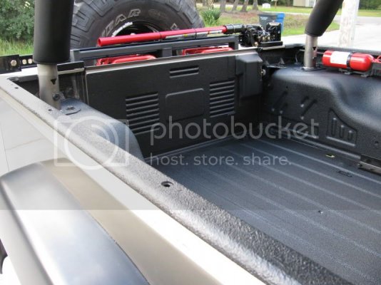

Rhino liner is good
As for prepping:
I order it online .. comes in a kit , 1 gallon and all the brushes and special rollers
Key is to PREP PREP PREP .. sand everything down to bear metal , clean with mineral spirits dry dry dry .. tape off and go .. first coat light .. second coat light . Then normal ... after 5 hrs cover it in the UV protector.
You can beat the **** out of it with a hammer and it wont chip if done right .
I did it on my last rig also .
Not only does it give it a ruggid look that no one has but protects the **** out of your paint
