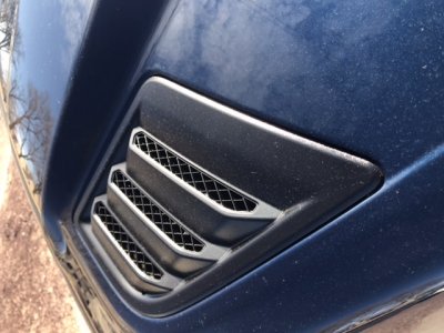

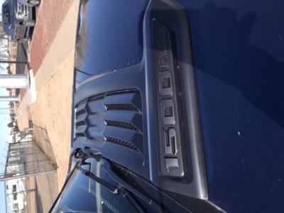

I plastidip’d mine in the Luxury Sapphire Black. I just masked off the majority of the hood and windshield. Blue painters tape slides right underneath those inserts. Removing the masking was much easier than expected and it came out perfect. A little orange peel but that’s on me. I did about 5-6 color coats and 3 thick glossifier coats.
I was going to remove them and dip them off the truck but that fabric heat shield under the hood didn’t want to come off easy. More specifically the inserts holding it in. So I just did it on the truck.
Apologies for the dirty truck pics...
