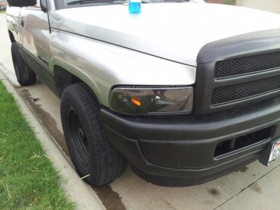

painted heads

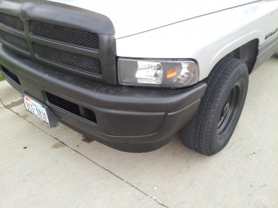

Woohoo, blacked out heads and tails!

It's hard to see in the pictures, did you paint the bowls too?

Nope I didnt paint the bowls.
Used 3M window weld to reseal it.

Thanks guys. It was really simple if you wanna do it.
I did it with all leftover supplies I had. 2 coats of plasti dip and 3 coats of lens tint to give it some shine so it'll reflect better.

Sweet! That's interesting. How'd you go about cracking em open? Just bake em and pry lightly?
