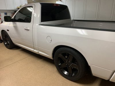

Just finished lowering my Ram and also installed a adjustable Panhard bar in the process. I believe you just adjust this with the truck on the ground untill the rear end is centered to the body right? Sorry for the stupid question, that aint my thing.

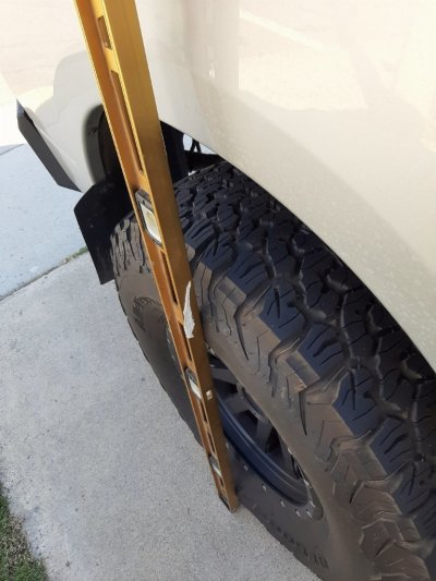

Yes, measure with tires on the ground with her full weight on them.
I use the edge of the tires past the fender to measure.
49554342236_5fda00ecb7_k.jpg2020-02-18_02-41-58 by RAM RSM, on Flickr
I have 1 3/4 driver rear, 1 5/8 on the passenger.
49554584632_beb2c8b3e2_k.jpg2020-02-18_02-42-12 by RAM RSM, on Flickr
Cool! I will do the same on mine....
