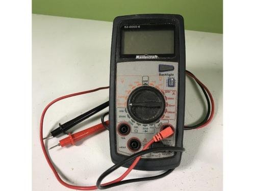

With my multimeter I can only read the amps for a few secs without blowing the internal meter fuse. Should you perhaps read the amps a little longer to get a more accurate reading? Does the startup of ECU etc. take more amps in startup?

Most meters will allow you to measure 10 amps without vlowing the fuse. You should be .02 of an amp after everything goes to sleep. If your meter has a 10 amp ability you have something pulling serious power with the key off and you need to find that or get a different meter.

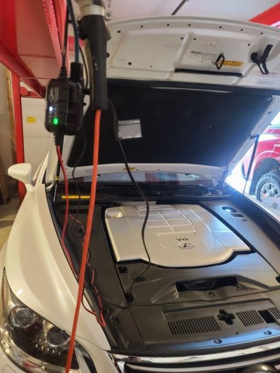

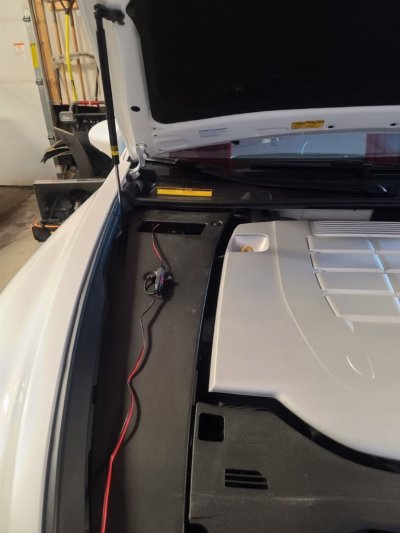

Since the car sits for long periods of time I have attached a NOCO harness to to the battery terminals to make hooking up the trickle charger much easier. This way I can just plug the trickle charger in without having to remove the clips and lift the battery cover each time to attach alligator clips. I have these quick connects on all my vehicles. Even at only 40 Miliamp, a battery will drop below starting voltage in about a month, if it is stored cold it will go flat faster than that. Remember, lead acid batteries do not like to be discharge down to 11 Volts and recharged. They are much happier and last far longer if kept above 12.3 volts and that means a trickle charger is a good idea if you don't drive your car for at least 30 minutes every 3 or 4 days.

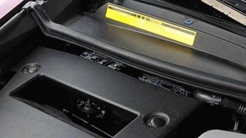

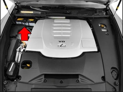

As a followup, Charged the battery to full, after an hour off the charger, read 12.73. July 2023 OEM Lexus battery. After sitting in the garage un-driven for 8 days, battery now reads 12.45. So the constant drain, even though very small, definitely draws down the battery over time. Battery went from 100% to 80% in 8 days. Still lots of juice to start the car. Left parked with no trickle charger, and assuming an even rate of drain the battery will be down to 50% in another 12 or so days.
At 12 Volts it is still enough to start the car but this is NOT what lead acid batteries like and will materially decrease its service life. If you aren't driving the car regularly your battery will last far longer if you put it on a .75 AMP to 2 AMP smart trickle charger like a Noco. The other option is to disconnect the negative battery during storage, but I find it a lot easier just to leave it on the trickle charger.
You can use the quick connect cable on the jump start terminals as well, they don't have to go on the battery itself. The reason I put them on mine was so I don't have to remove any of the under hood covers or the battery cover to hook up alligator clips each time I wanted to put the trickle charger on. On my LS you can't reach the battery terminals without opening the battery cover by the windshield.
Here is a picture of the LS460 Battery location. The panel with the Yellow sticker has to be removed at min to get alligator clips onto the battery.
If you can only read 10 amps for a few seconds without blowing the fuse, you have a serious draw somewhere. How are you hooking this up? Remember to keep the doors shut or tape down the actuators for the driver's door to avoid pulling amps for interior lighting and waking up the vehicle when opening the door.

I have done my troubleshooting similarily to yours. Also put the key fob a good distance from the car. The only thing that I did differently was with the multimeter. The meter I have, a cheap one, says it can only read up to 10 amps for 10 sec. So I only read the amps for a few sec then disconnected the leads so as not to overload the meter fuse, so I thought.
I "only" get 2 amps with everything off. So perhaps the meter could survive reading the amps for a few minutes and try leaving the meter hooked for a few minutes and watch the readings. From the reading of these 2 amps, the reading instantly jumps up to 4,5,6 amps when opening a door or turning something on, as it did for you.
Am gonna try reading the amps for a few minutes to see if the amps stabilizes.
Sorry if I was unclear, the multimeter is 10 A fused and it says that you should only read higher amps for max 10 sec to not blow the internal fuse.
Am I understanding correctly that the right way to measure amps is to leave the multimeter attached for a few minutes?
Yes leave it attached even for hours. As long as you didn’t hit or exceed 10 amps you should not blow the fuse ever.

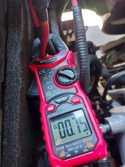

Call me lazy but I just can't be bothered installing an ammeter in series with the battery, when a DC Clamp meter is so inexpensive.
I bought this on sale from Amazon dot ca for less than $40. I believe they're less at Amazon dot com.

Yeah I was thinking of getting a clamp meter. How's the accuracy on that one?

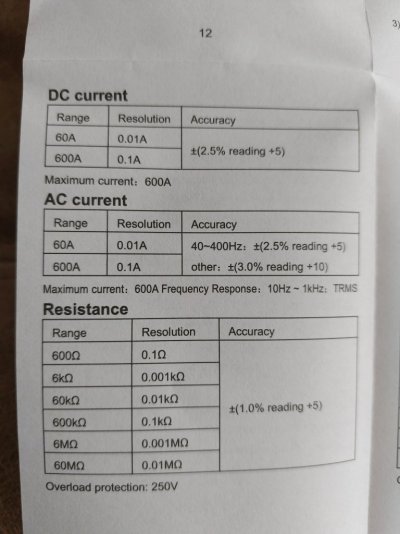

Clamp on meters are handy but most are not accurate to .02 amp so make sure you check that before buying. Most of the cheap ones only claim accuracy to .5 to 1 amp. I have one that is accurate to .02 but it was a lot more than 40 bucks.
If the readings are inly accurate to .5 it isn't really telling you what is going on. Also, make sure it reads DC amps, many of the cheaper ones are only set to read AC amps. The good thing about clamp ons is they usually read to 1000 amps so they work good for diagnosing starters, alternators and other high draw applications.

This unit far surpasses the requirements, AFAIC.
The spec'd resolution for the clamp meter I bought is 10 mA with the accuracy at +/-2.5% @5, according to the manufacturer.
When set to the 60A scale, you get two decimal places visible or 10 mA.
Most parasitic current draw issues I've come across have been much higher than 10 mA.

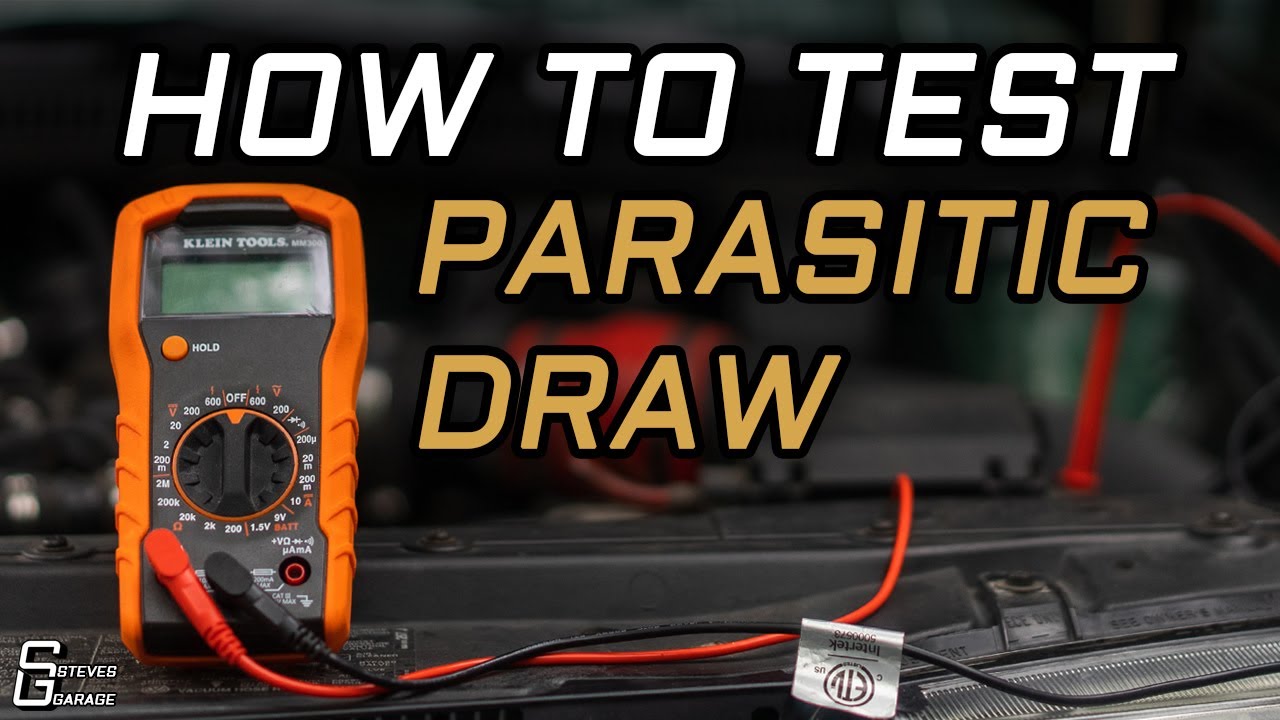

Watch this video - it explains it well:
