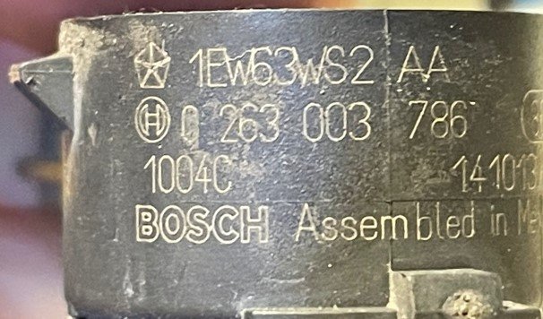

Tested all 6 front sensors. My pins are not in a triangle but rather a line. Pins labeled as shown in the photo.
For all 6 sensors, R1-3 = 50 Kohm, R1-2 ranges from 132 Kohm to 143 Kohm, and R2-3 = ranges from 186 Kohm to 194 Kohm. These resistance values are not near 9-10 ohms. I suspect my parts are different than the ones you are describing Dean2.
I bought a set of replacements from 1AAuto and the resistance values R1-3 = 2.2K, R1-2 = 34K, R2-3 = 37K.
My OEM sensor info.
