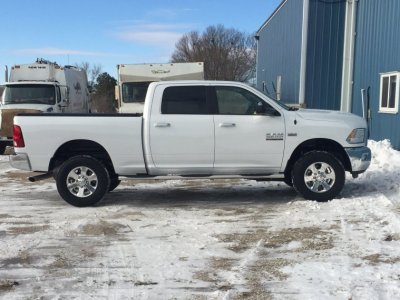

I bought a 2015 2500 6.4 hemi crew cab in the big horn trim with 6'4" bed. I was curious as to what the actual legal payload would be vs what my sticker said (2,840) so i went across our local scale last night. With a half tank of fuel my truck weight 7,140 with me in it. So 2,800 pounds of true payload in my specific truck is what i am looking at legally...
