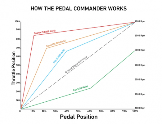

Please help me understand how a pedal controller makes a throttle plate open quicker. The throttle plate is controlled by the ECM. The pedal sends a signal to the ECM. That signal tells the ECM what position the pedal is at. The ECM is going to open the throttle plate faster when it receives a signal telling it that the pedal has been pushed farther or faster. When it is being told that the distance and time to distance are more than that pedal motion would normally produce, it responds accordingly.
When you push the pedal, it sends a signal to the ECM, which opens the throttle.
Pedal Commander sends a higher or lower signal which opens the throttle at higher or lower % than "normal"
Example. Push the Pedal to 50%, throttle will open 40%. Pedal Commander takes that signal before it goes to ECM. 50% Pedal, now changes the signal to 60% (depending on the mode)
As you see below, in Sport mode, at 10% Pedal, Throttle is opened to 85%.
Now question is it worth to you and/or do you actually need it. But it does work, if that is what you are looking.
Here is example from them.
As for the people above. with issues. If you go to their webpage. and look at trouble shooting.
It is likely the reason for your check engine, and they explain what to do. And to avoid doing.
It's also possible it's damage
Right. Can't go over 100%. Literally no spot on the graph that can't be replicated by simply pushing the pedal further. PC gives you more or less granular response, which can be useful, but doesn't open the throttle quicker, etc because it isn't communicating to the throttle except through the same middle man your pedal already does.

No gimick, I takes the lagg out of the pedal response, It boost the signal to the ECM by what percent i don't know
It's not a set percent, depends on setting, see chart above. It can't go over 100%, so signal boost is simply recreating pushing the pedal further. What it does is give you more or less granularity (more for 'eco' settings and less for 'performance' settings) in the response. If 10% of the pedal sweep now recreates 50% of the pedal sweep, of course it's quicker and less 'laggy' at 10%. It's like you instantly stabbed the pedal to 50%. Easing into the pedal is easier than stabbing to 50% (and actually hitting 50% vs 75% or flooring it) so you get that 50% take off much easier due to reduced granularity. 100% is still 100%, though, which is why flooring it is the same with or without and there's no "opens throttle blade quicker" occurring.
