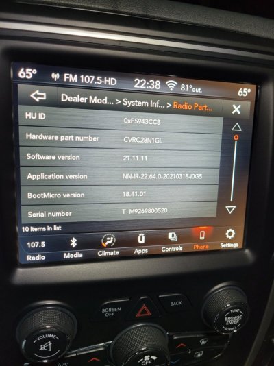

Recently updated the radio using the file in the photo for my UAS
Alfaobd
Vehicle is an SRT
Turned on performance Pages
Done.
It didn't work til the next morning when I found the app in the unconnect app drawer.
It seems like it's still loading as it really doesn't let me change any settings for now other than the steering settings.
I might have to activate some other settings to get anything out of it.
Still no luck with the off road pages though.

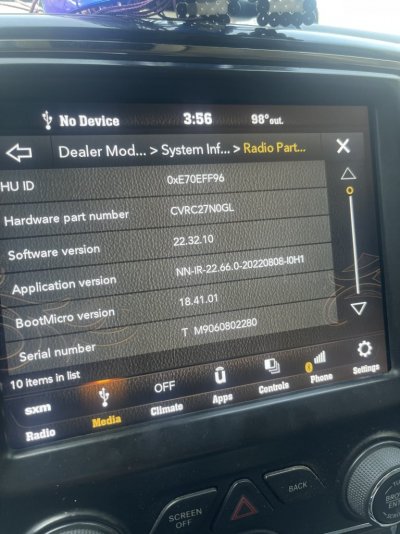

I see, I just ordered the 4c radio and was seeing that mine is just about the same as the original post, did exactly what he did and didn’t end up working. Was trying to figure out if you needed to update to 40.1, so there’s no possible way of getting these pages on the ram now?

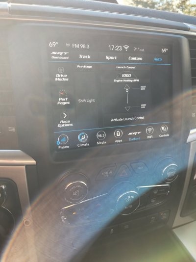

I would like to know more as well, mine is almost there it just wont load the actual app, it has the icon on the apps screen and the drawer though.
USPatriot1776
Nov 21, 2022
44
49
Kentucky

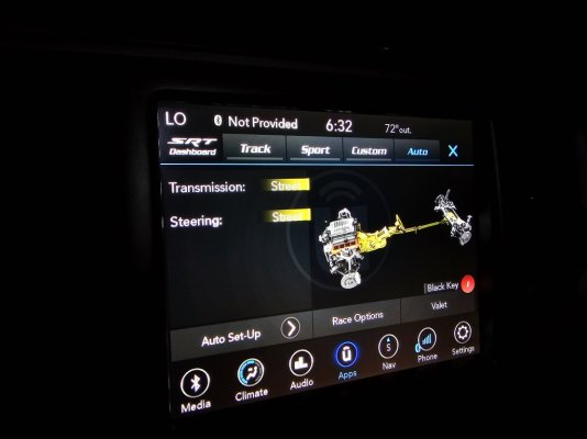

After a little tweaking with the BCM settings, I finally got the SRT Dashboard to work.
Oddly enough performance pages still do not work but I changed a couple settings last night and will update if they change functionality.

Be sure to post the exact settings you used in AlfaOBD so others can use your thread for the quick fix! I might give this a try too!
