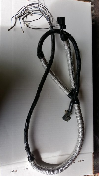

Well, if you go stand alone trans, it makes the 03/05 swap very simple. The top three plugs C1, C2 and C3 are identical to the 05 plugs. You will need to add 8 wires. Two are grounded, two splice into existing wires and four will be pinned into empty holes in the three plugs. All that's being added is the 2/1 and 2/2 O2s wiring. As for trans I chose to go with a 46RH/A518. The trans bolts to the hemi, however a special flexplate is needed or a engine/trans spacer. (PATC) A 05 manual trans starter is also needed. Edit: the A518 is the same length as the 545 and uses the same driveshaft. I had to slot the trans mount about 3/8 of an inch to bolt to the trans using the 545 mount.
