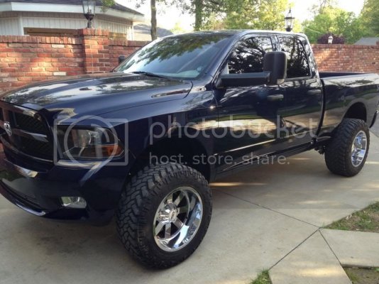

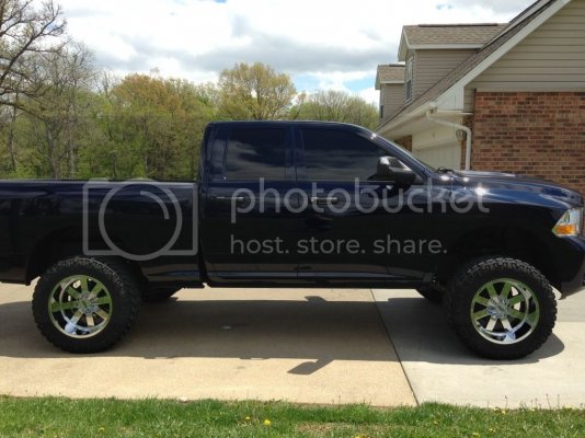

This is sick!!! These are the wheels I want, does anyone know if I can get away with 20x12 -44 w/ 35x12.50s on a 4" RCX???
thanks man.. i love the deep dish on these wheels... i cant really answer your question though.. I know you could pull it off with just a 6in lift by its self.. i have a 6in plus spacers so about 8in of total lift. if it didnt fit you could always add spacers all the way around to give you a total of 6in of lift.

sorry should have worded it better. The truck has a 6in ZONE lift and i belive the 5in springs in the rear.. the shocks that came with the lift were ditched and blisten 5100s were added.. the rear is technically the only thing with a spacer and the front is what you call "leveled" i guess... sorry for the confusion. i do know the zone 6in lift came with a spacer for the front already.
The 6" Zone kit only has options for 3" rear coil or 5" rear coil
Sounds like you have the 5" rear coils
As for the front, there is a 4 7/8" strut spacer and 5/8" pre load spacer.
Since you have Bilsteins, the pre load cannot be used
So the only spacer I see that you have is the front and nothing else. UNLESS....you are running a 2" rear coil spacer which does not make sense if you are leveled with bilsteins
lol, let me just take pictures of it all tonight.. Driveline Plus in evansville indiana installed everything on the truck and i was told it was equal to a 8in lift.. i know for sure i have a zone 6in and blisten 5100s.. i thought they said somthing about spacers in the rear but maybe not. if i take pictures would you be able to tell me exactly what i have?

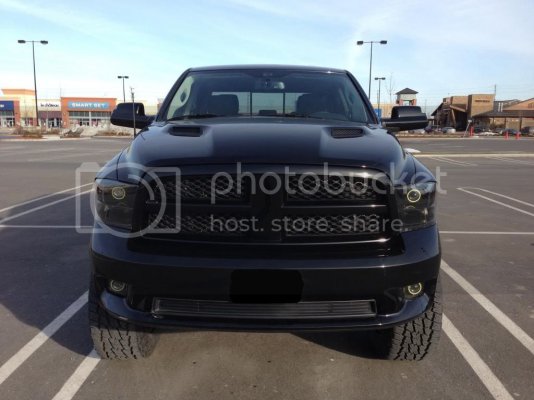

What kind of lights are thos and where can I get some. I've been looking around for lights with a black housing I like with matching fog lights and there nicer than most I have seen.
