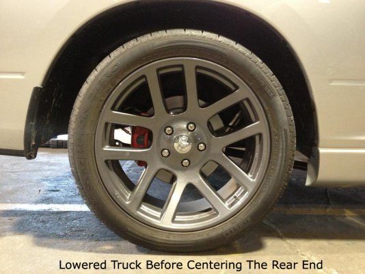

I'm wondering if anyone has a pic from looking straight on with the rear wheel after being lowerd, on stock control arms, so I can see how off centerd in the wheel well the tire is. Anyone with srt 22s would be a big plus

I measured mine after lowering 2/4 belltech. It was 1" forward on my 2016 R/T on 22's . Sorry no before pictures though. You can see it forward in the pic.

Thanks for the reply, you can definitely see when comparing how good the front looks
