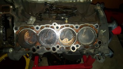

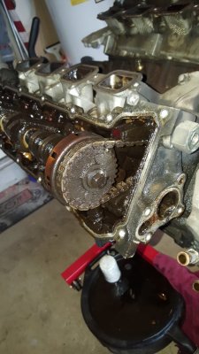

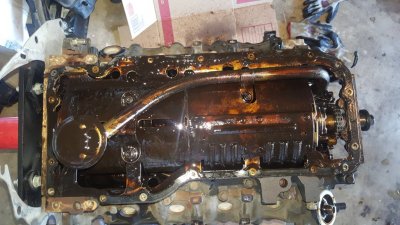

So I finally rebuilt the engine, there was oil sludge everywhere and the piston ring gaps were so worn that my largest feeler guage (.80mm) still had room to move between the ends, one piston had damage to the crown and the timing chains were stretched and no longer holding proper tension

I recently rebuilt a 1990 Eagle Talon TSI and it didn't even look close to all that sludge. Lol
