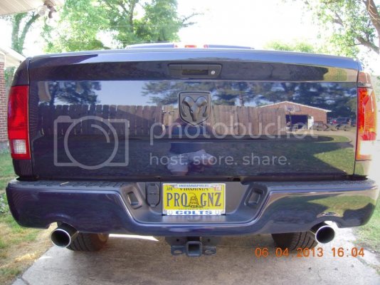

did all my badges. NEXT RIMS!!!!!!!!!!!!!!!!!!!!!
truck is kinda dirty:

Looking sharp! I'm still in the air. I only have one badge and am considering this. Last time I plasti dipped it came out sorta textured. Mind sharing your method?

I washed it with hot water and dawn dish soap
Dried it
Rubbed with rubbing alcohol
Tapped
Sprayed 4 coats

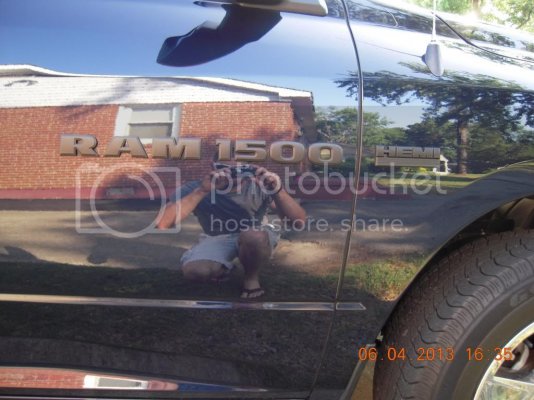

Your HEMI badge looks great! How did you get it to show so well with the paint over it because mine aren't that good.

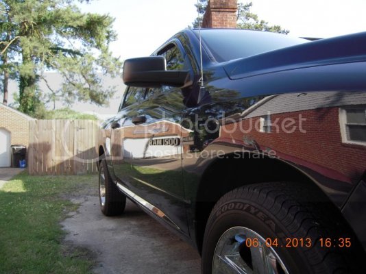

Looks good..hopefully it won't wear off for you like it did for me. I did about 5 coats and after about 6 months it was wearing off! Next I'll actually paint them!
Washed it with dawn soap and hot water then went over it with rubbing alcohol and painted it
I hope it doesn't wear off

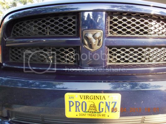

I did my girlfriends badges this past weekend
It seems to me that the farther away you spray it the more texture you get
How heavy of a coat also is a factor too, when I first did her pillar I did light coats and it came out textured
