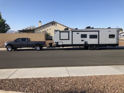

5A0ED523-DEE3-4116-BAF0-C4F3DC975088.jpeg This trailer max is 13,780
my truck is rated in the low 12,000lbs for bumper tow. Yet the truck man handles this trailer as far as control goes. Hill climbing is decent if you are not scared of 4,000rpm.
Ratings mean very little nowadays. Looks at half tons that have the same ratings as 3/4tons.
my old 5.9 2500 mega cab has less rating than a new f150 or Titan.
the weight police can kick rocks when they bring up numbers because the above comparison. And no your insurance will still cover you unless you are something really stupid.

Because it's not safe to do that.
Your picture shows an extremely squatted truck, with a LOT of weight taken off the front tires. Your setup LOOKS unsafe.

20190927_165459.jpg Screenshot_20200526-084249~2.png I am well under my capacity. And my trailering experience is calm cool and collected.
If you meant @blinker. Glad you saw this.

Yeah. Way over. I bet there is no weight on his front at all. Must be fun driving at night.
But the truck manhandles it. No need to worry about being 2 to 3 k overloaded

@392DevilDog I was quoting him...I think? No, I see I quoted you, but I was referring to his picture. I really thought it I was replying to him...sorry about that.
I know you've been around the block on here several times, and your stuff generally looks set up right. His definitely doesn't.

Bldrinker's truck is not "extremely" squatting. It appears level to me, which is why they have a rake when not loaded. Truck is level, trailer is level, it "looks" safe to me. An experienced driver goes a long way when you are close to maxing out too.
