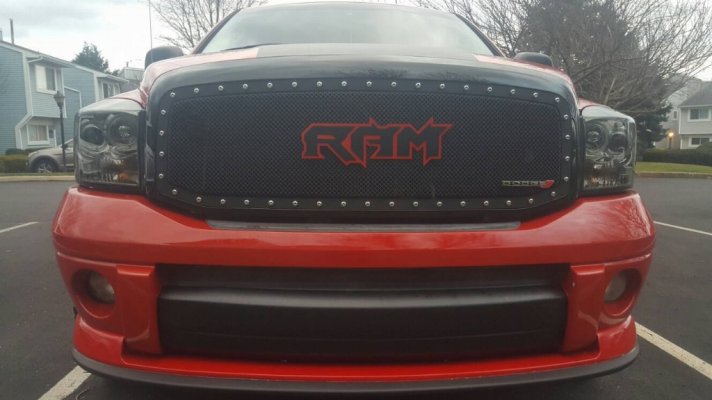

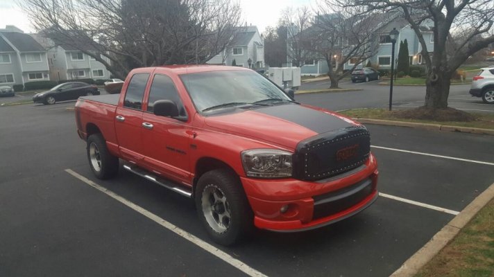

I'll be sure to post pics once I'm done. Just for the hell of it, here's a front end picture of my truck.
