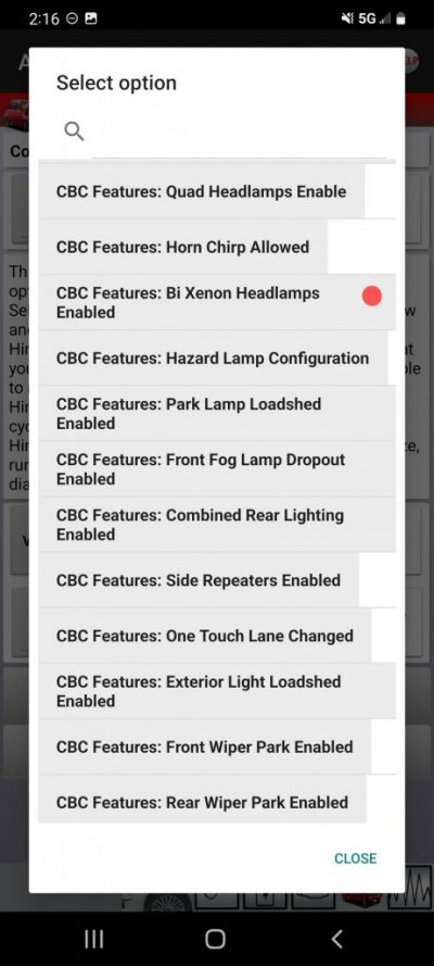

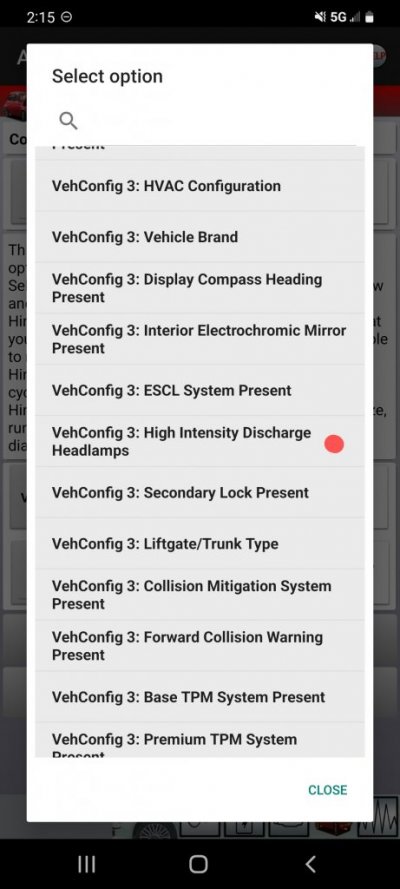

Fog lights shouldn't be monitored at all, and should have no issues. However, you may try enabling the following settings highlighted by the red dots.

I've invested into alfaobd and have changed all the settings. Going to take off the decoders on my fogs and see hiw they work.
With alfa obd, if a bulb goes out will the canvas system still tell you after you have set everything to led?
Yes, if a bulb goes out, it will still let you know. I've had led 3157 taillight bulbs drop a few led chips (most still worked) but when using the turns or brakes, it would trigger a bulb out error.
