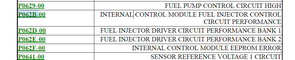

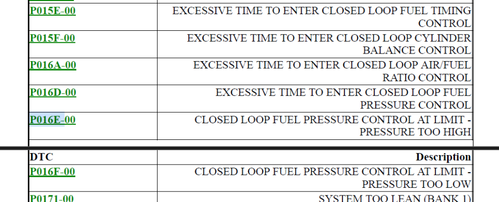

The P016-00 codes:

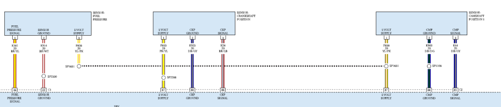

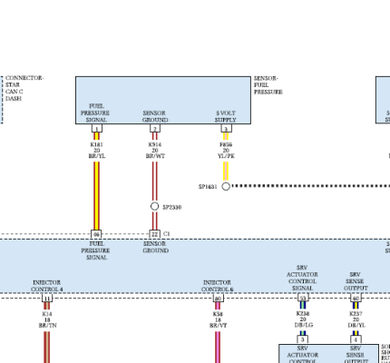

The best I can find, P018b refers to the fuel rail pressure sensor:
It's a really simple circuit that shares it's power supply with the cam position sensor
It should be pretty simple to verify 5v at the yl/pk wire at the connector, then verify the integrity of the signal and ground wires between the sensor and pcm.
Once those are verified, replace the fuel pressure sensor.
