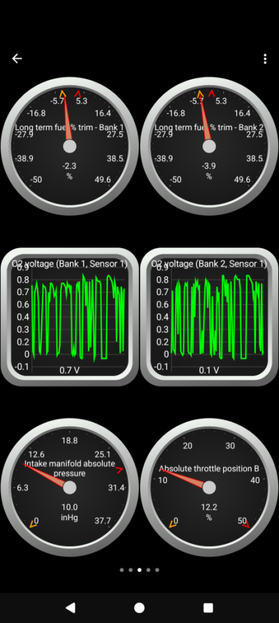

At this point, I'd be pulling the injectors and getting the flow tested or checked to make sure they're all flowing equal AND the right amount. I think it'd be worthwhile investing in a noid light to make sure the injectors are all firing the same amount and duration. You keep looking at the throttle body, but I believe that's wasted time and effort. Your O2 sensors should be switching back and forth, not pegged.
This what the O2 sensors should be doing.
You mentioned map voltage, but not actual map pressure. All these functions I'm showing here, are available via the obdlink app using the mx+.

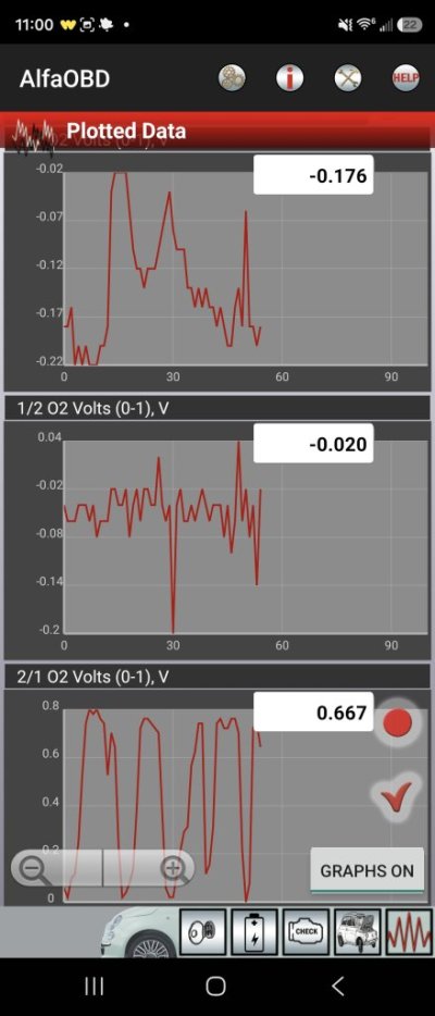

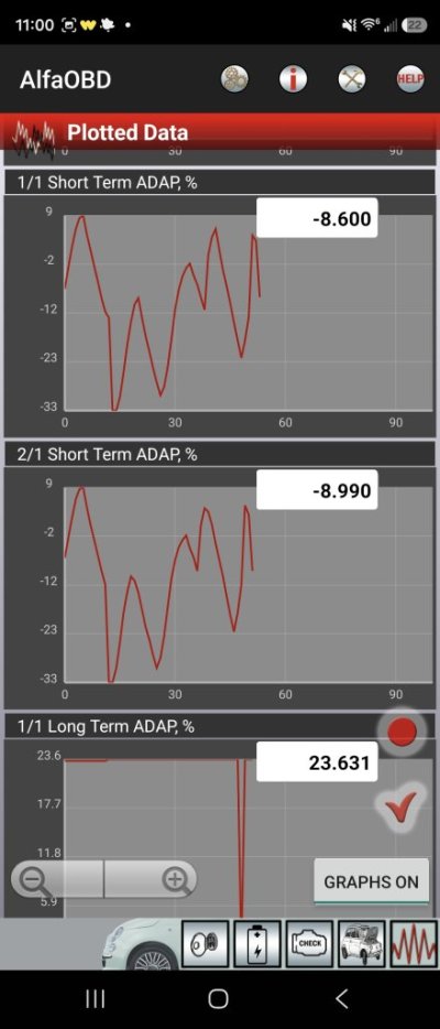

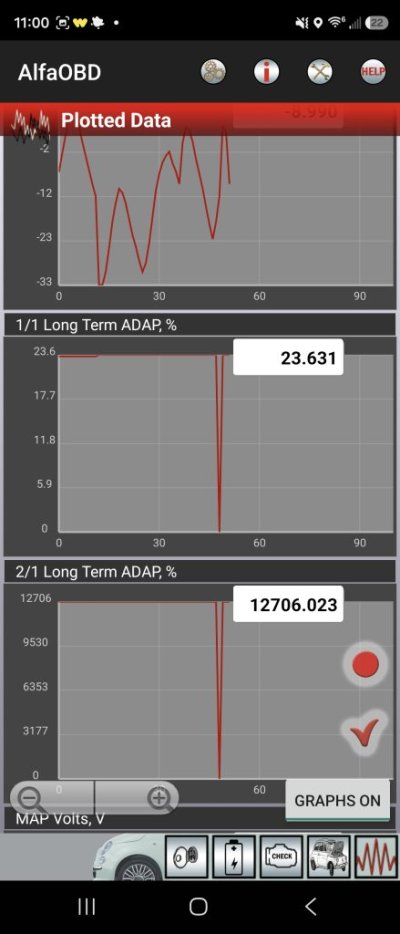

My intake manifold pressure at idle is 9.74 inHG
My map vacuum is at 20.118 on live data and. Manual gauge
And my throttle position looks almost identical to your on start up goes to 15 then trims back from 8-10 at idle before it starts to surge
But my long term fuel trims indicate i cant get to read other then -
1/1 reads 23.631%
2/1 read 12706 %
My short term is
1/1 -33%
2/1 -33%
My 02 sensors reads like that my
1/1 reads hit or miss like that or try to stay negative now and ive changed it 2times now but
2/1 reads ok to me
but I have to use spark plug non foulers to space them out some since I run no catalytic converters of i dont I will code out to rich with the long tubes

Wait, are you running non foulers in the upstream or downstream sensors?
The reason for running the non-foulers isn't for checking enrichment, it's looking for effectiveness of the cats, so it's looking to see that the oxygen level has been stabilized.
The non-foulers pull the sensor out of the flow of exhaust so it's not getting a direct sample. The voltage at the downstream sensors should be fairly stable and not be bouncing around like the upstream sensors do.
Like I said before, I'd be hooking up a noid light and checking to make sure the duty cycle on the injectors is fairly even and just a blip and not a long flash. Make sure they're doing what they're being commanded.
Might be worthwhile investing in a wideband o2 sensor and plugging it into one of the downstream locations and seeing what it reads to get a baseline.
Otherwise, if it's truly running rich, something is either telling the computer to dump a boatload of fuel via the injectors, or the injectors are sized wrong and the computer can't compensate.
Have you run any new grounds? I'd run a fresh one right from the battery to the body. Then from the body to the engine. Body to transmission. Even if you just get some basic ground straps and use those.
I wouldn't get a handheld tuner for trying to troubleshoot this. If anything, you're going to need HP tuners on a laptop where you can monitor and see all the tables to see exactly what's going on. Even then, I wouldn't even get it tuned until the issue is resolved. Throwing a tune at it is likely just a bandaid to cover up the real fault.
If you have an mx+ reader, download the obdlink app and try running some fault scans on that. I find that app gives more exact information than Alfaobd when it comes to actual faults. Scan all the modules, if you start seeing weird faults on various modules, then it's quite possible you have a bad ground and you just don't know it.

Yes I run small non foulers on the upstream and longer ones on the down stream . And yes ive installed multiple grounds one from battery to body , one from frame to motor , and added another one to the pcm mount to body
And I was going to check the vvt valve before putting the intake back on but other then that guess it time to check the injectors again to make sure they are doing what they are told
