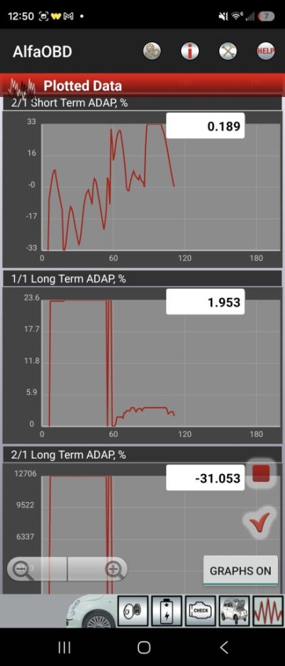

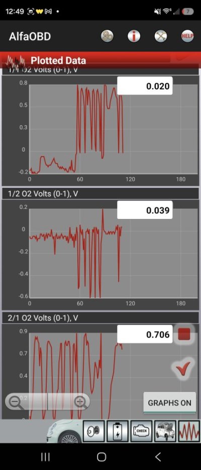

They data now is definitely different
All this is with the foulers removed
1/1 - range cuts in and out ever now and again fluctuations tighter then flat lines then come back (2nd new senor too)
2/1 fluctuations great band width from .1 to .8
1/1 short term -3.7%
2/1 short term 0.189%
1/1 long term 1.9%
2/1 long term -31 % but good o2 upstream data
And only codes are lean on bank 1 not 2
It's only pulling fuel on bank 2. But 1 is what's coding it would make sence if its on the same bank to me
1/1 long term 1.9%

Those numbers are starting to pull closer to where they should be. Have you disconnected the battery for an extended period of time? If the sensor isn't oscillating between 0.1 and 0.7 volts fairly consistently at idle, then I suspect there's an issue with the sensor and could be contributing to some issues on that bank. Try pulling that sensor and cleaning it, it's probably full of carbon build up.
Disconnect the battery while removing the sensor so you give the computer time to reset.
