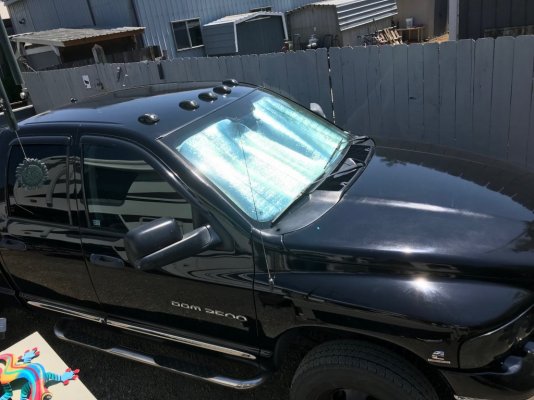

I know, I know, this is an old thread, but I wanted to share some new experience regarding this topic. I had (keyword here is had) a whole lot of peeling clear coat. My truck was looking like a ****** even though it runs like a top. DW rolled in a bedliner and under the cab sills about a year ago and it still looks fresh. So I got me a quart of Rustoleum Gloss Black and some thinner and went to town on the hood, cab, and fenders. I wet sanded with 1200 grit first, then rolled on the paint with a foam roller. DW looked at and said she could do better with a brush. So I wet sanded again until the rolled on paint was smooth and she went at it with a brush. (It did look better, but don't tell her that). I then wet sanded it down to smooth black paint and then took McGuires Ultimate Compound to it and WOW! Then I threw on a coat of Carnauba Wax for protection and put my shades on just to look at it. I'll see if I can get a decent picture. It's so bright and shiny the camera just glares haha.
For you cheaper (read frugal here) guys out there, the entire job cost me less than $30.US plus a lot of time wet sanding. Sooo worth it.
