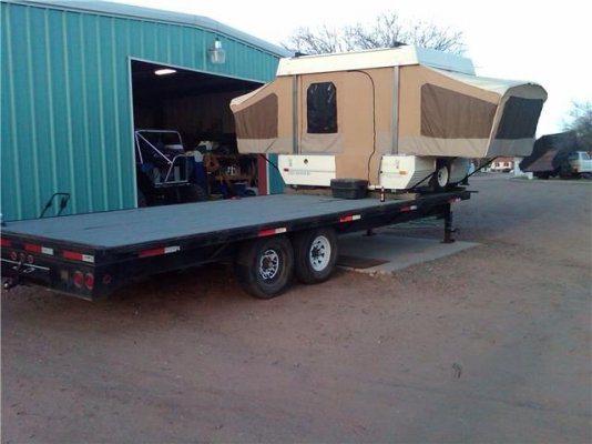

Im looking to build something like this. Any guesses on how long and wide this trailer is?
I would guess about 18-20ft long and at least 6ft wide...
Have any of you guys done anything like this?
Edit: Just so you guys know what I'm working with.
80/96” wide and 24’ long.
Couldn’t tell if it’s a gooseneck or bumper pull.
I thought about building something similar a few years ago but it was gonna be a lot longer though. I couldn’t find a suitable donor(pop up) trailer so I squashed the idea.

Im looking for a bumper pull. This is exactly the kind of setup im looking for. Im thinking of just finding a trashed travel trailer and only using the frame. Reinforce where needed and let her roll.
Thanks for the comment. This gives me an idea of the length and width ill need.

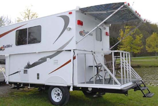

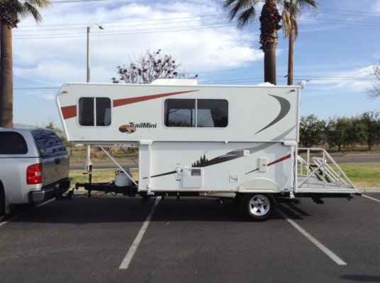

Maybe look at a high/low style camper (Trailer Manor) That would work too.
I don't know if this would suit your needs better, maybe another style option. I was looking at these too when I had a project truck.
That is definitely a gooseneck. Can see the pin peeking. Dont know the length, but 8 bolt axles , probably a standard 96 inch wide trailer. Judging by the frame rails , 8 bolt wheels and being a gooseneck its probably a 10-12k trailer.

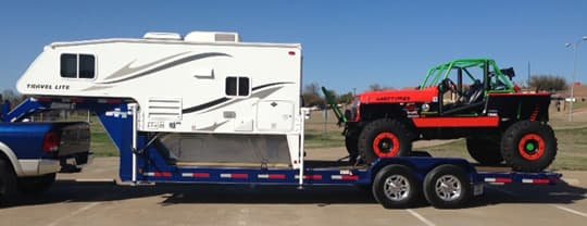

A couple of thoughts: Most pop-ups have a body quite a bit longer than 8ft, so placing it on the trailer sideways isn't gonna work. Also, the roof may need some rework with the latches etc to withstand 70+ mph winds perpendicular to its original design.
Here's another idea:
Obviously you could use a pop-up truck camper to lower the profile.

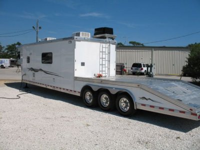

Something like this on the front half, and then you would have room on the back half for the Jeep.
When your not using it, you can collapse the top down for storage and what not. You might even get away with having it down when towing with the Jeep on the back....get rid of the hand railing if it isn't integrated. The lower half only looks to be about 8ft??? Parking spots are usually 7ft wide just guestimating. Folded down the top part maybe 11-12ft overall length???
Might be a nice little option if you can find one in a deal....just an idea.
