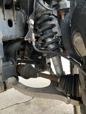

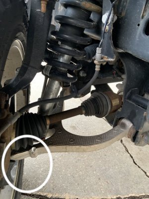

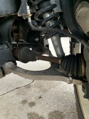

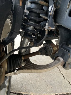

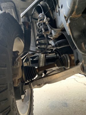

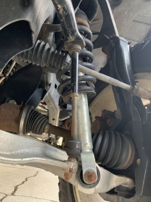

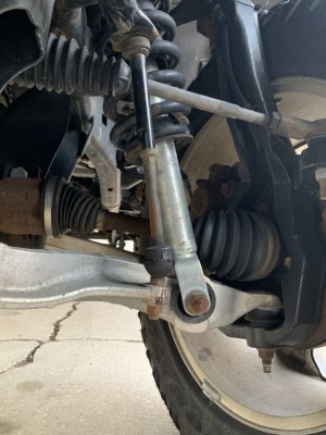

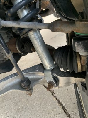

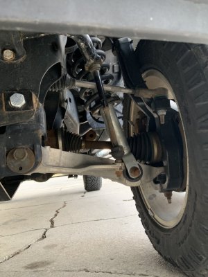

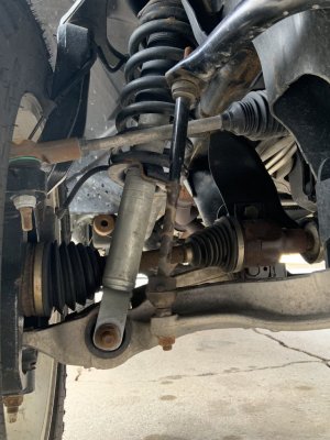

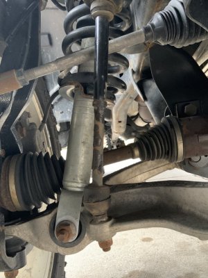

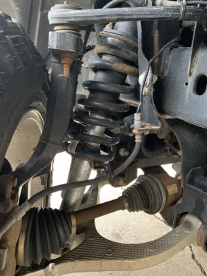

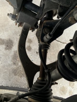

Attached are some photos of truck suspension.

Anyone see anything from the pics that looks out of place, or not sitting right?
Anyone detect the noise from the video and might have an idea of where to start?

I suspect you may be hearing the turn stop on the control arm binding against the stop on the knuckle. Will happen at full lock when you lift and change the front end geometry. Looks like fresh metal exposed there on the lower control arm. Just a suspicion though.
I wonder if the end of your axle is hitting that spot on your control arm when you make the hard turn?? Or if it’s your axle cv joint that is popping/clicking. That’s pretty close to the noise that the joint popping in and out would make. If you grab your axle in the middle of it, does it have a lot of play if you pull and push it towards the engine or away from the engine??
