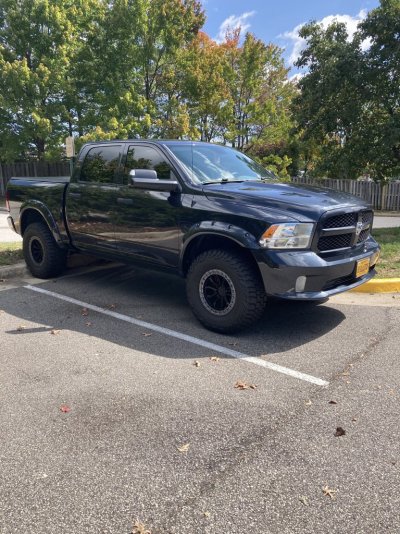

I have 15’, it has been very reliable, no major problems.
Mine is an express, so less options & no rear window but perfect for me.
Good luck with you search/purchase, tons of useful info & great members on this forum!
