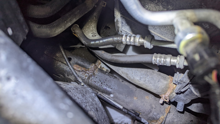

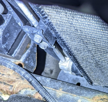

I'm not seeing an aluminum block there. I just see lines running into the transmission cooler, and some what I believe are lines from the AC system.
Unless you mean these small blocks
I did happen to notice some wetness on these two lines going from the transmission cooler down to transmission. Feels like it's coming from the upper connectors.
If you do have the transmission thermostat,it'll be towards the upper pass side of the grill,in front of the rad and A/C condenser
