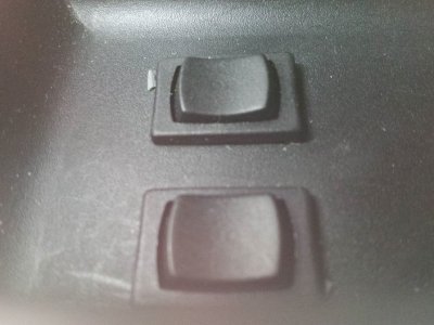

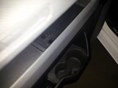

I added the upgraded door panels so my switch location may be different than yours if you have an Express. I used mini DPT momentary switches. They have six prongs and will work for reverse polarity. They work great. I got them on eBay but you can get them on Amazon as well. I use them everyday at work and they work perfectly . I love being able to have control of both mirrors separately . I just took some pics for you but it's dark out. You can still see where I mounted them in the resets in the door panel. They are very small so finding a location will not be hard. If you need any more pics let me know. I also added a pic of how to wire a reverse polarity switch. Not sure if you were familiar with it. It's very easy.
