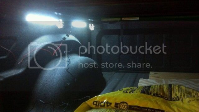

Did only one side and has plenty of light. The finished product is cleaner than the picture shows. I ran a wire from the trailer plug. I even left it on overnight by accident but being LED didn't drain the battery.
