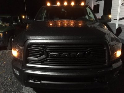

So I went ahead and ordered the kit from JHD lighting mentioned earlier in this thread. It’s a nice little kit with everything required. I installed it today.
This is not a difficult mod to do, the hardest part is fishing the wire through the rubber “boot” between the doors and the cab. On the cab side of that, the end of that boot is one big plug with little room to do anything. The drivers side has the parking brake assembly right in the way. The passenger side has more room in that boot, there are fewer wires.
There’s not much room to use a fish tape, so I borrowed a small fish wire from my wife’s sewing kit, thin rigid wire with a hook on the end, it worked very well.
Once you get past that it’s just cutting one wire in the door on each side and crimping the kit in, then hiding your wiring under the dash. My roof clearance lights were installed by the dealer, so I had a convenient power wire to tap into. Here’s a pic of the result, it’s dark and rainy so not a good pic.

So no issues wiring them directly to the 12V clearance lights? I'm looking at a way to re-wire mine and debating on using the clearance light wire (I have some ready to install - I'm just scared to drill) or run them from the relay box I added that only supplies power when the truck is running. I assume the lights in the mirror are 12V, but you never know with trucks and computers these days...

Yep no issues with using the clearance light wire. If you don’t have clearance lights, you can tap into the parking light wire at the headlight switch, same difference.
The mirror lights are LED so the kit has resistors and diodes wired into them. It’s all inside the heat shrink already, so it’s plug and play. The hardest part is pulling the new wire through the boot between the door and the truck.
