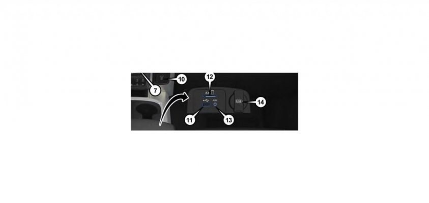

This is what the outlet inside the armrest looks like. No 12volts
@RAZ175 I can't quite read the wiring diagram you posted. Can you tell me what the wire color is suppose to be? Thanks
So I have a 2017, and I thought the interior was the same between 2017 and 2018, but where you have a USB-C port, I have a 12VDC outlet (cigarette lighter style). So either Ram got forward-thinking and swapped the 12VDC outlet for a USB-C port ahead of the competition (largely - I say this because my wife's 2019 F150 does NOT have a USB-C port in it anywhere), or someone has swapped out your outlet panel for an updated one. Did you buy the truck new or used?
I bought it new but both ports are standard size USB. No USB-C port.

Ah. At first glance the right one looks like USB-C. Looking closer I see it is not.
Regardless, my '17 has a 12VDC outlet where you have your 2nd USB outlet. So evidently there were more changes between those two years that I thought.
