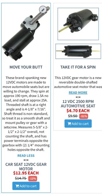

I had looked at replacing on motor on my last Dodge, an 03. I Googled about it and found some motors cheap at American Science and Surplus. Can't remember what the motors look like, never did the swap before I sold it. Still have motors. Here is what the have now. Picture was just taken from their web site. Only requires a few mods, obviously to the plug and I think had to cut the screw shaft down a little.
