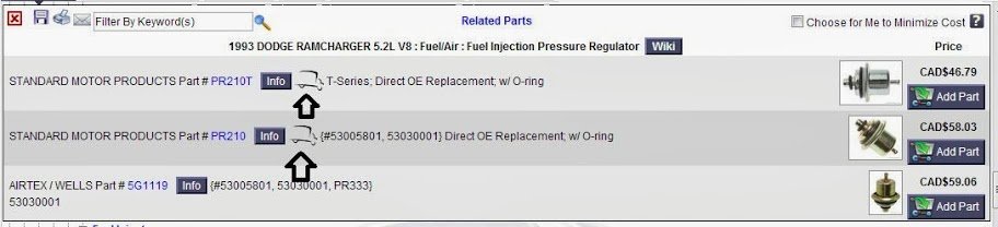

find another shop to safety your truck lol. that is definitely a rip off. yes a steering box will cost $700 if you buy it at a local parts store but you will get $400 back when the core is returned the core so it sounds like they were going to try screwing you out of $400 more than they should have. if you want to do it yourself you could probably fix the leak yourself. your issue is most likely just a leaky input shaft seal. it is a very common issue. you may also want to inspect the steering coupler. it may be in need of a rebuild and you need to take it off to replace the input seal or replace the steering box. as far as parts go you might want to check out rockauto.com. i find they can sometimes be way cheaper than the local stores. just got to what out for the shipping icon to try getting it all shipped from 1 location
