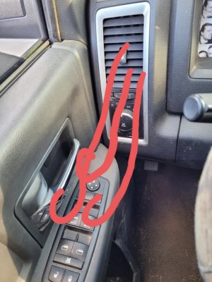

Ive replaced my D/S window switch 3 times before i figured out what was happening. There were 2 causes actually. 1: I used to keep my heater closest to the door at a downward angle and after awhile, it would heat up the solder on the switchs board
2: i keep my window cracked rain or shine and water had gotten inside the switch causing corrosion build up
The fix, get rain deflectors on your windows and/or dont aim the heater on the switch

You may have had a bad solder, but I seriously doubt that the heater duct pointing at the switch area got it hot enough to create that problem. Unless your heater is putting out 700 degrees Fahrenheit.
