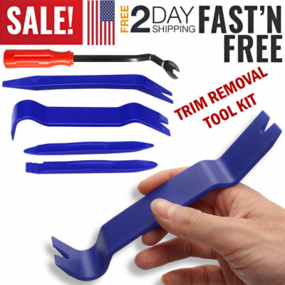

first pick up a set of plastic trim tools
you can buy them anywhere, auto parts or Hardware store carries them. the reason for using Plastic, it will not scratch the interior or exterior.
Then pry the passenger door switch up
spray the contacts with electrical contact cleaner & work the buttons
You may have to check out the passenger door switch, to make sure the electric plugs are seated
