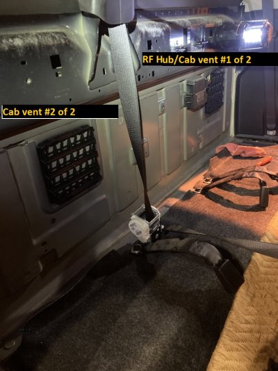

I was reminded this morning of another point of water ingress, although less likely for your truck's vintage.
Is the back wall becoming wet after a rain shower or is it the floor carpet and/or storage compartments in the floor?
There are two plastic vents in the back wall used to equalize the cabin pressure when closing doors.
On older trucks, the rubber or silicone flaps on these vents tend to decay and fall off, leaving an open passage between the cab and truck box.
