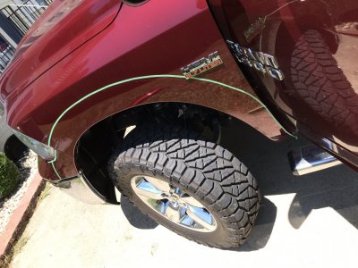

62DCF282-EF20-4A3F-84CB-59C45158FC11.jpeg DA896D7B-49D5-4F35-99DF-41F2843B3D3D.jpeg
Buy clear ppf roll with a thickness just wider than the contact patch of your flares
Temporarily place the flares and bolt them up
Take bright and thin (so it’ll curve easily) painters tape and use it to mark the outer edge of your flares
Remove the flares
Put the ppf on the inside of this painters tape line
Remove painters tape
Permanently install the flares and all the pets of your flare that contact the truck will have a buffer or ppf underneath it and it won’t be visible since you did such a good job of marking the flares with the painters tape

If you zoom in on my 1st pic you can see the clear ppf is already installed
All I did after that was take the green tape off and install the flares
