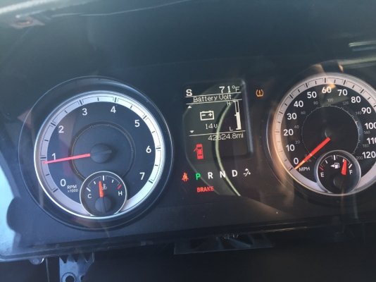

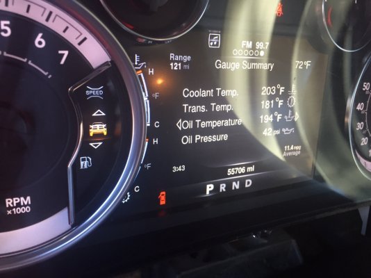

So, I took my cluster out and plugged into my friends truck and worked with everything, so definitely a truck thing, idk if it's a sales code issue or what...
Cluster in my truck:
Same Cluster in friends truck
His truck is 2014
His cluster in my truck.
SitKneelBend
Moderator
Member Relations Specialist
Jan 8, 2015
10,941
7,610
St. Louis
3.6 Pentastar
His truck is a 5.7 2014
This is good for folks to know. I'm sure you can sell it...

I have a premium cluster and I was watching some YouTube videos, and I realized i don't have a lot f the functions.
I don't have oil psi, battery voltage, battery page, a total hour just idle running.
Also can't figure the oil temp issue. Oil temp and coolant temp are exact same.
Feel like I'm missing half of the options any guidance would perfect.
Like if I need to get it reflashed

Oil PSI is most obvious to see that it's missing in his pictures.

So in those pictures the premium cluster is mine, but in two different trucks, so there a miscommunications between the truck ECU or PCM and it's not talking to cluster... So I need to find out if I need to add a sales code or just not compatible for truck
The oil psi for some reason doesn't work in my truck, or oil temp, if you see in the first pic, oil temp and coolant Temp are the exact same and the oil temp gauge doesn't work, reads 0
But in the other pic with p cluster, all options are there and gauge is there with accurate reading

I'm guessing it needs to be reflashed and according to the dealer ship my truck came with JA6 which is the premium cluster according to parts dealer...
But these are the sales codes that I'm going to try and research
I think it may need a flash with JAV OR JAT?
On the second image it maybe could be LAD, LAR, or LAT LAZ
NOt sure what I may need but those seems like they'll work? How can I check to see what truck has already on it?
