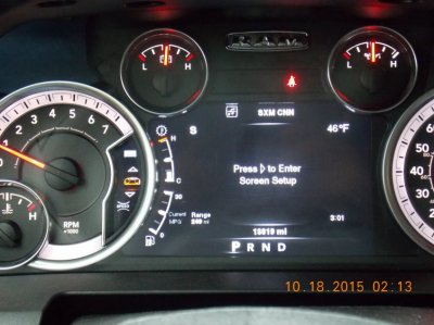

I have a premium cluster and I was watching some YouTube videos, and I realized i don't have a lot f the functions.
I don't have oil psi, battery voltage, battery page, a total hour just idle running.
Also can't figure the oil temp issue. Oil temp and coolant temp are exact same.
Feel like I'm missing half of the options any guidance would perfect.

I have check everything, I am missing a page in vehicle information, missing a gauge on the gauge page, missing an entire section on EVIC, don't have total hours where it has drive and idle hours... This may be because I don't have trailer brake controller but don't have that either

I have the tip top cluster option... I don't think the would omit simple functions because its not a hemi, but it is Chrysler so I don't know...

I figured it was all normal until I started watching youtube videos and my friends truck with the crap cluster, it has more accurate info. New cluster from Chrysler is about 1.1k... I almost want to take it in and maybe either get a firm ware update if there is one, or a reflash. I dont think the cluster is broken... I know I keep asking Ricks Ram, been busy, couldnt schedule anything... Happen to have that spare cluster to plug in and see?
Also is mileage programmable? (side note)

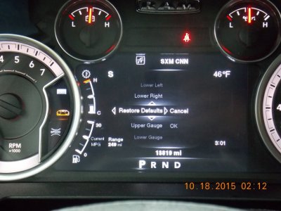

It may sound very elementary and may not help but it might just cure the issue. Did you try a factory reset on the cluster? Mine kept telling me I needed to service my air suspension, which my truck does not have, until I did the reset. I know in my case mine was a transplant and yours is not but still worth a shot.

Yeah i have done restore to default, unplug the battery and tough the two terminals together, left unplugged for an hour, done all of it
