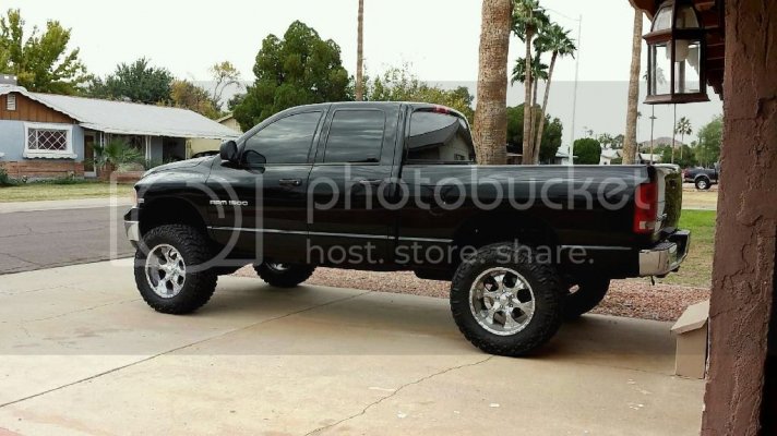

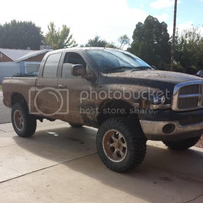

Hello everybody, im new to this site and have a few questions on building a prerunner.
To start off I own a 2wd 2004 Dodge Ram 1500 5.7L hemi 6" febtech lift with a 2" body lift 20" wheels on 37" tires. My main question is would I be better off with the body lift or without to build a prerunner? I only have a body lift to fit the 37" tires I want to rebuild the gears to a 5.13 for the tires, if I took the body lift off I could only fit 35" tires so it wouldn't be worth rebuilding the gears. I want to get mid travel so I dont have to cage my engine, any good places to look for upper control arms?
Pictures of my truck

My gawd thats a good looking truck.
