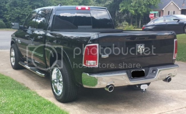

I know in my hunt to find information about wheel fitment I was getting alot of mixed information about what I would have to do to my truck to fit certain size rims/wheels. Well I figured I'd share what I just had installed for anyone interested in a similar fitment.
I have a 2wd completely stock suspension not even a level kit. I also have the OEM fender flares installed which encroaches into the wheel wells more yet.
I had my new 20x10 -24offset rims installed yesterday and reused my stock tires for the time being. I plan on going up a few sizes in width once I need some new rubber. And yes there is the room to allow the growth.
Below is a direct link in my build thread with more pics but I'll duplicate one in this post for context. I'll try to take some close ups pics and repost with the front tires turned at like +/- 30 degrees as that is my worst case position on clearance to give a better idea.

Cool, I would figure it would poke out a little more.

Well three factors that are making it appear to not stick out as much. First I have fender flares. Second these are the stock 275 tires still that curve in at the tread unlike if I where to be running say 295s. And lastly I have the nerf bars that visually bring them back in alignment almost.

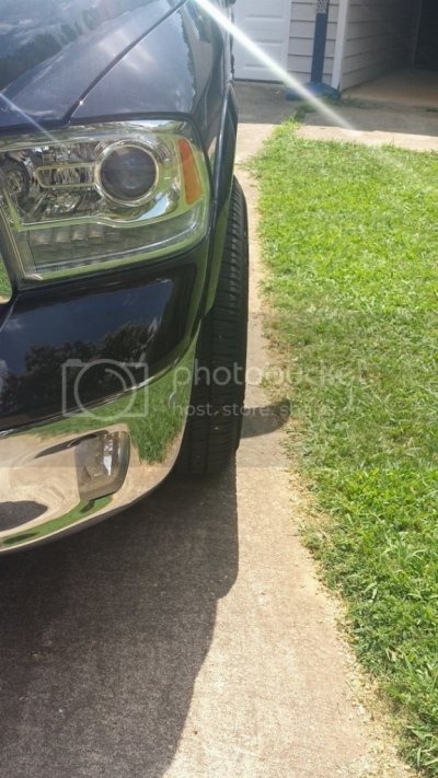

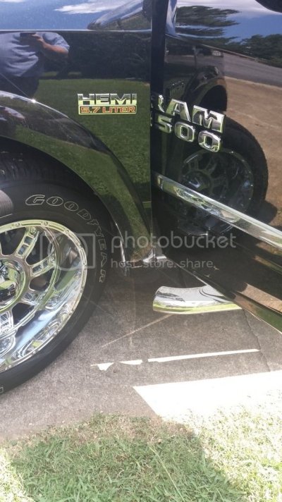

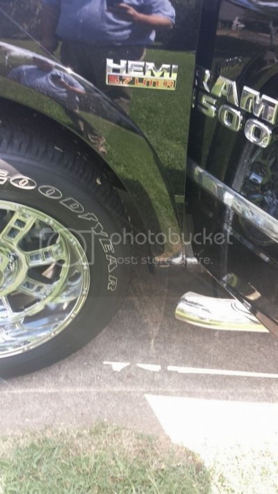

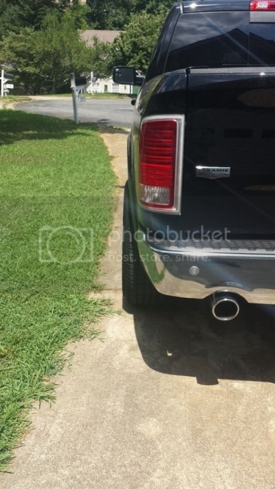

Ok here are my additional photos I mentioned.
The last photo makes it look worse than it is (I suppose from angle of shot) from edge of tire to stock wheel well its about a 1.5" clearance at the tightest spot

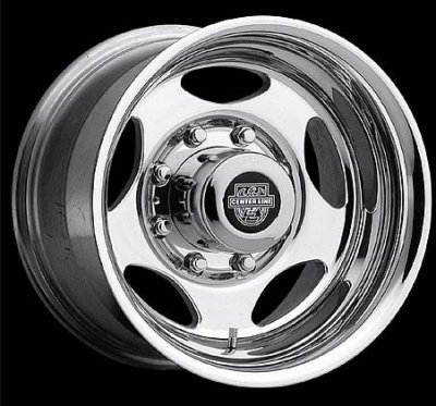

Yes I know, going mud terrains. Always had the white lettered BFG's in the past but $538 a tire plus shipping is just stupid so I am looking at Toyo's or something else.Here is the wheel I have ordered in a 20x10. Can't wait...

Cool those have that old school heavy duty look
