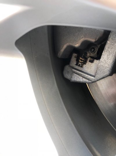

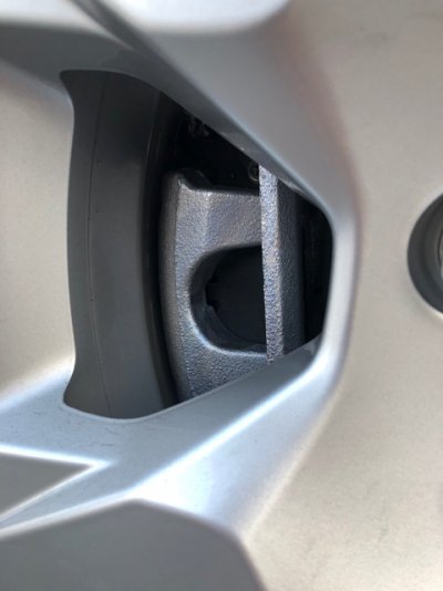

I’ll get a pic tomorrow. I can’t even fit my Speed Master wheel brush between the caliper and wheel.

Here you go
Front
Rear

OmG, they have those things with NO leeway whatsoever. I wonder what the mindset was behind this ?
You can see the designed the wheel around the rotor caliper. You can see the recessed lip around the face.
I was actually excited about the 18” wheel. I like the 18” wheel with 35” tire. 20” is ok I just like more sidewall

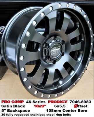

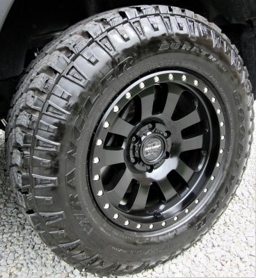

I have 18" factory wheels on my 2019 Laramie, but dang I like the looks of Pro Comp wheels above. Thanks for sharing, I think.
