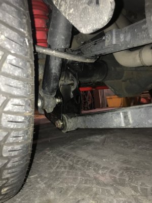

So I made another order from moes last week, my illicet cut brackets came in and the hellwig sway bar and the air bags. Couldn’t be more pleased with the change it gave my Mcgaughy 2/4 kit. No more vibration or squirrely rear end. Bags helped the rough ride with all the bad roads. Now just waiting on my ARH long tubes and y pipe. After cutting 1 coil out of the rear coils I only lost 1/2 inch. Might have to cut one more to get level. On an added not the guys at moes are some of the best in customer service I’ve ever seen.

I had a rear vibration that made me think a sling a wheel weight especially at 65-70. The rear end was tail happy to say the least and the pot holes here made me feel like it was a log wagon. The decision to do the cut brackets was because when I talked to the guys at moes he said if you go any lower that a 4in in the rear the upper control arm mount will hit the frame. Also I removed the bump stops that came with the mcgaughy kit. The air bags keep it from bottoming out. They also let me raise the rear I’ve i need to for a heavy load. Finally the sway bar really help the body roll since my truck didn’t have one. Thanks for the compliments I love these trucks there are so many ways to put your own cool on them. Your looks cool as well. Qa1 shocks are next here and then look out I’m gonna void that factory drivetrain warranty

How long did the install on the "cut brackets" take? Were they easy to set up? Can it be done without removing the rear axle?
It took me 3hrs only because my plasma cutter crapped on me. Lots of cutoff wheels and unibits I used a reamer after the small unibit and it worked out fine. You are cutting the entire upper control arm mount off and it is made of thick steal. Patients is your friend. I did not remove the rear end but I did lower it as far as I could without having to disconnect brake lines. I did take the brackets that hold the line to the frame loose for more clearance

Thanks for the info it will really help me out. I don't mind taking all apart and hanging the axle on stands but I would rather not disconnect the brake lines.

Pull the diff cover,pop the axles out ,unbolt the backing plates from diff,and leave the brakes and backing plates attached to the truck is the easiest way to pull the rearend out . I've done a few Illicit brackets now,and it's definitely easier to do with the housing out from under the truck.Also a good time to change diff fluid.If you don't have access to a cutting torch or plasma cutter,go rent one.You can't make all the cuts you need with a cut-off disc,there's a couple cuts that are virtually impossible to make with a cut-off disc.
