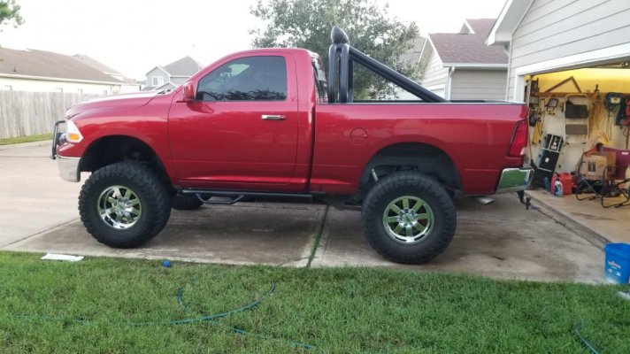

I have a super lift (which Mopar uses on their trucks or at least they did in 09) paired with a 3" body lift. No issues at all. Iv been running it since 09.
