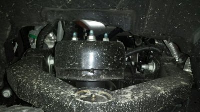

I had my zone uca installed. I was looking at them today an the arm that is toward the front is very close to the strut mount lip(the thing that flares out)
Driver side has maybe a 1/4" of space between the arm an housing, the passenger side has less than 1/8". I don't think that it's actually rubbing or at least I don't hear it.
So my question it to others with zone uca installed. Is this normal? Do they all fit this tight? Thinking I might need to take it back to have them adjust something

They are side specific and may need to swap sides. The ball joints are not completely centered on the control arms. One side of the arm is slightly shorter than the other. The longer side should face the front of the vehicle putting the ball joint towards the rear. Make sure they installed them on the correct side.

My ball joint is toward the rear. But on the picture you posted doesn't look like the metal flares out around the base of the strut mounting housing.

This is the passenger side

This is the gap on the passenger side

if they are on the proper way, no issues driving, i wouldnt worry about it

To me, it looks like it is on the wrong side but maybe they updated the design. I recall seeing more clearance. The shorter arm and ball joint should be closer to the door with the longer part of the arm closer to the front of the truck.
