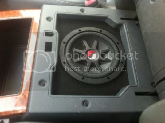

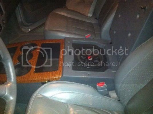

okay thanks. I think I have found all the components that I will need. I am thinking about placing the sub in the lower storage area of my centre console, it should fit well if I take the plastic insert out and I don't really use the space for much anyway.I would then place the amp under my drivers seat. The reason for this is that I want to keep the rear storage under my back seats free for tow ropes, chains, booster cables, etc. So my question with this is has anyone else ever done it this way(any tips of what to do/avoid?) or is there a reason no to do it this way and go behind the back seat instead?

just an update, i ended up going with a new sub and got er all installed. heres some pics:

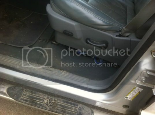

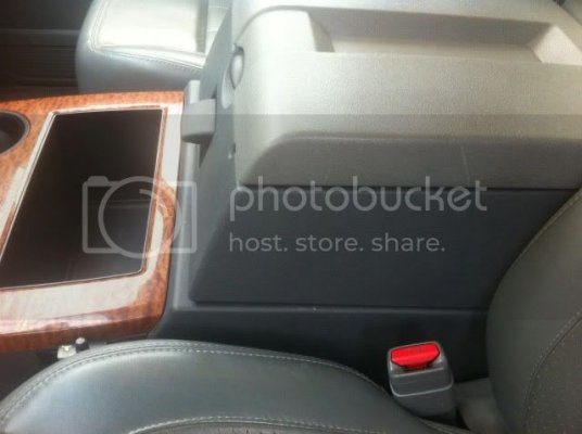

ya tying into the back speakers would be your problem. I tied into the front left speaker using the wires coming from a main plug in the left side of the driverside footwell. You have to be careful and make sure you know exactly what wire you're cutting when you do this as there are a lot of wires in the bundle. The wire colours for the left speaker in my truck were the green with light blue stripe and green with yellow stripe. I took my door panel off and took the speaker out to make sure I had the right wires and I suggest you do the same, the door panel is easy to take off. I snapped a couple of quick pics for ya, don't know if they'll help much as you can just see a bundle of wires.

Just wondering how and where did you hide all the wires
L
Lyndo
May 24, 2011
14
i ran the power wire through the firewall, under the door sill and then under the carpet to the amp. The signal and remote wires i ran behind the dash under the steering column to the centre console, then ran them under the centre console and then under the seat to the amp. All the speaker wires and extra rca's are just ran from the amp under the seat under the console to the sub box.
