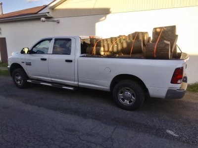

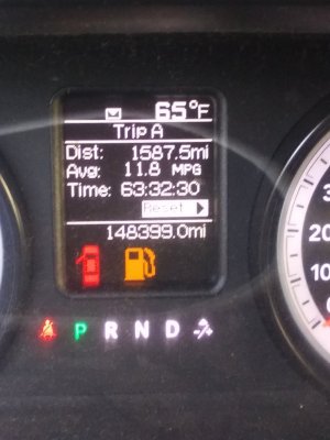

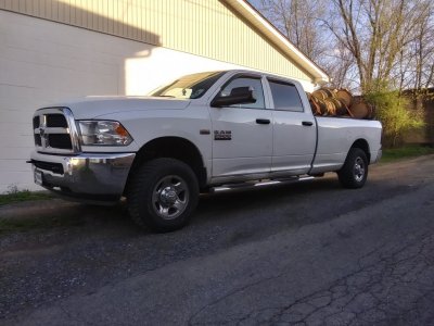

Mine gets worked like this all the time. I could not have loaded any more in a 3500...so the 2500 works fine for me.
She loves to work. You got to work these HeftyDuty trucks. No one told her she needed a Cummins.
