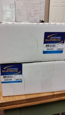

Here's the part number for the Mevotechs as well as a pic of what they look like! I haven't driven with them on yet, truck is still in the shop being lifted! The look decent though.
The one dealer local to me who does lifted trucks is charging 300 to recalibrate the spedo. IMO it's far more beneficial to get a tuner for just a bit more and then have the benefit of extra power to make those heavier tires roll!
