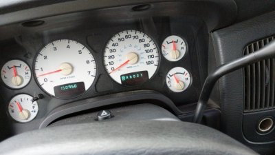

So today was my longest drive due to traffic. I'll start be saying that I wish my gauge had numbers on it haha. But today (judging by my gauge) itit got what I would say is closer in temps to what I would see when I had a 195 thermostat in it if i drove for an hour.
In my head I'm thinking it's something with the coolant not actually being cooled because it's constantly flowing through or it's not cooling in the rad. I'm not sure but this is why I am here asking
