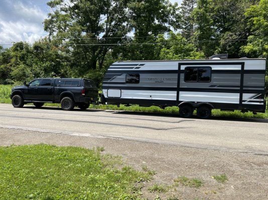

A good wdh will do wonders! I use the Equalizer 1200 for my GD Transcend, very close to yours! It’s worked for a much heavier PrimeTime Fury also!
I do have Loadlifter 5000 bags also!
I tow at speed on the highway, no noticeable porpoising or sway!
The weight distributing hitch is a necessity I believe!

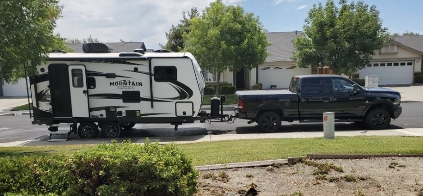

Towing my Outdoors camper dry weight is only 5500lbs, water and all my junk in both the camper and truck add another 1k to 1.5k lbs…when towing with a 2016 Tundra V8 it really struggled over mountain passes with tow/haul trying to keep a speed of 25->30mph…with my 2015 RAM 2500 W/Cummins 6.7 I have to keep a eye on the speedo…wants to 70mph plus…what a difference…I’m a happy camper
